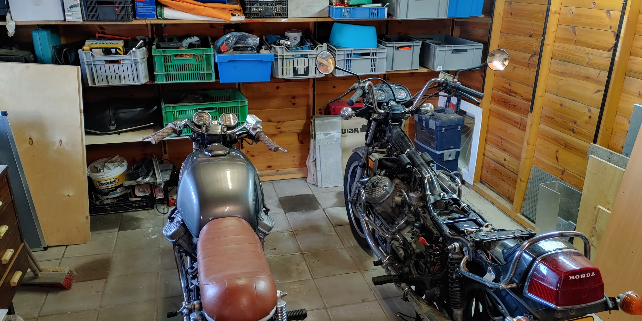

1e foto: https://2xcx500.blogspot.com/2021/02/fotos.html
CX motor 2x
Mvg joep.
